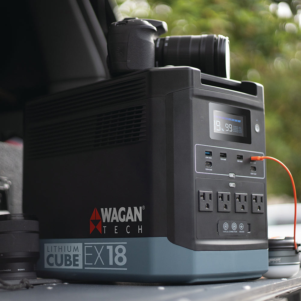

Lithium Cube EX18
Introducing the next generation of power stations, the Lithium Cube EX Series! The Lithium Cube EX18 power station features an updated long-lasting LiFePo4 battery, Fast-charging, UPS (Uninterruptible Power Supply), Pass-thru charging, Parallel capability, and just plain good looks.
